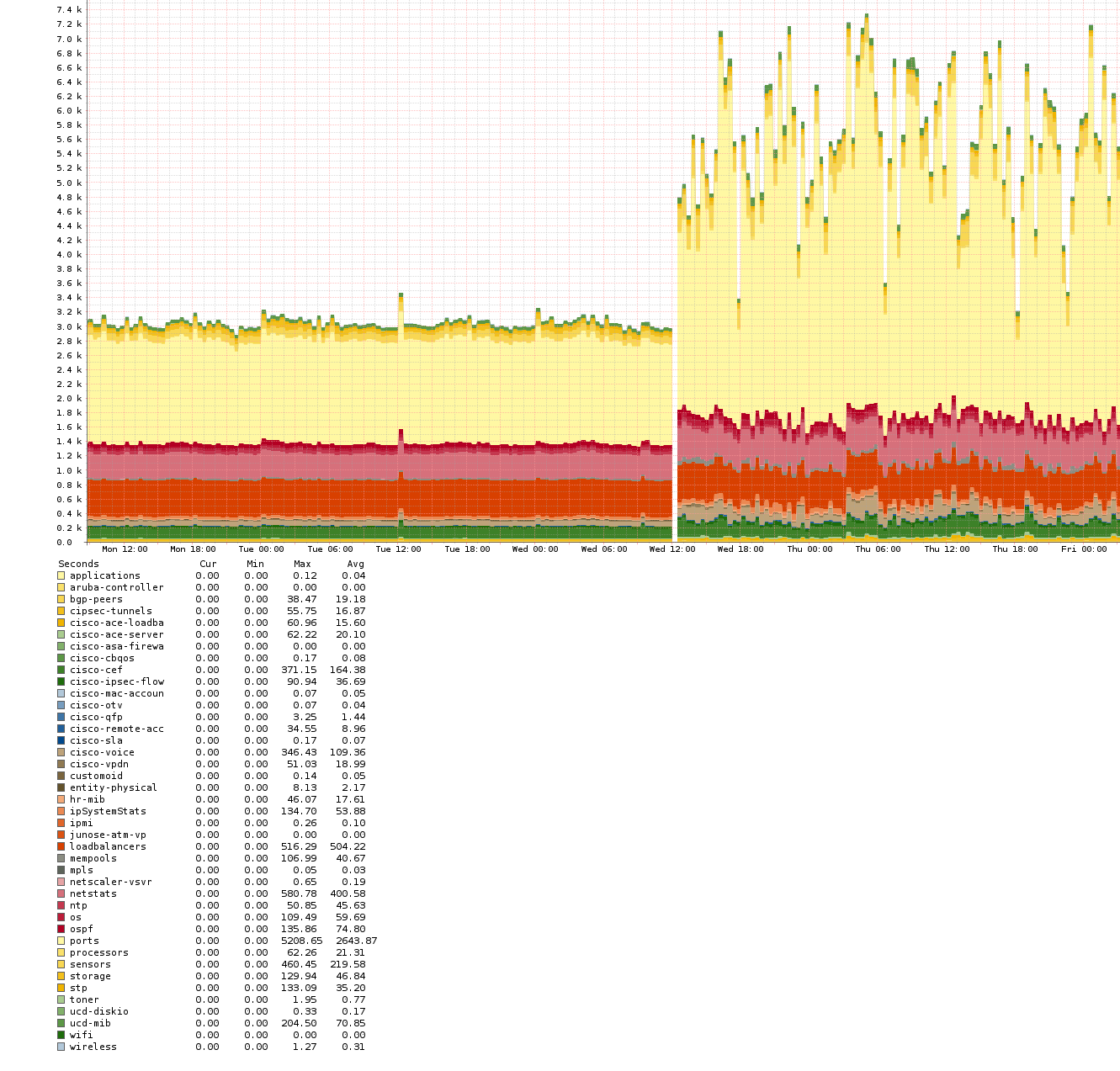

Poller performance regression in 1.59
I reverted to the ‘legacy’ poller-service.py service (from librenms-service.py) and it performs much better.
I have actually realized I raised something similar ages ago:
It looks like the problem is still there to some degree - and performance of librenms-service.py got somehow worse in recent releases.
Seems like this thing is getting confused by Nexus routers as well a bunch of UCS 6300 FIs - disabling them brings polling back to acceptable levels.
