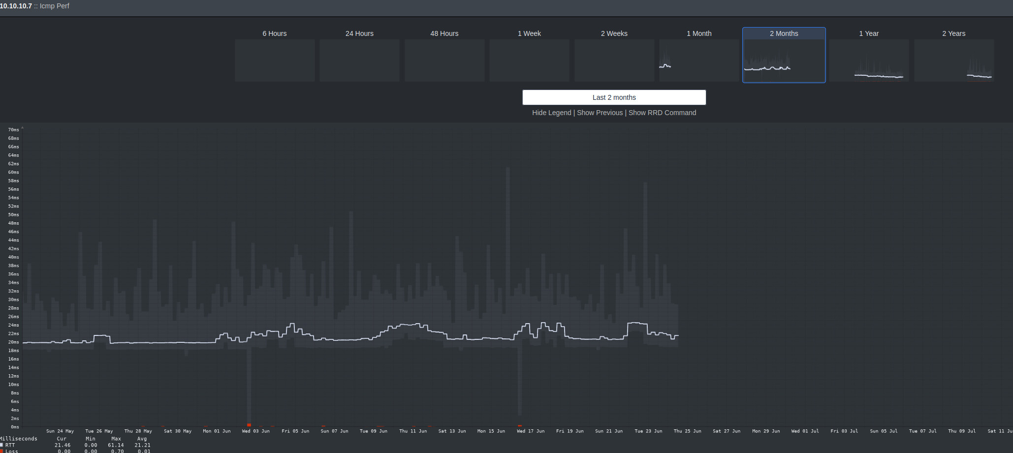

Poller ping response / Icmp Perf graph, no longer showing data for devices added a year ago
I can go in and delete the device and re-add it, and device will show Icmp Perf graph. Is there a way to fix this besides deleting, then re-adding devices one by one? I would prefer to keep historic data, but it’s not critical.

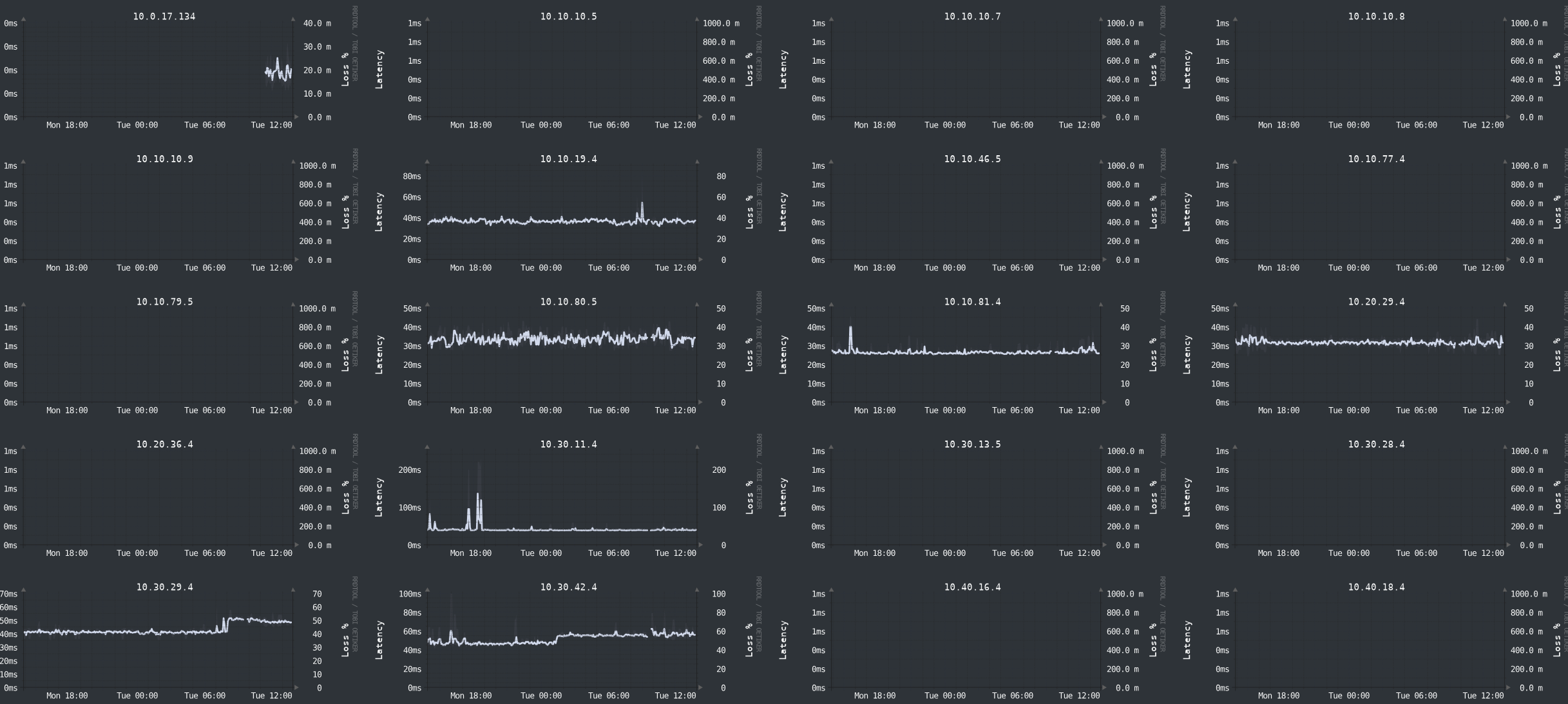

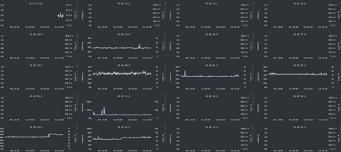

I got about 150 devices. Any devices added before November of 2025, the graph just shows empty after June 24 2026. only 18 devices are currently showing the graph, which all have been recently added in the past 8 months.
What’s weird is that all other graphs. Just the poller ping response. I checked the poller graphs and nothing seems out of the ordinary with it.
