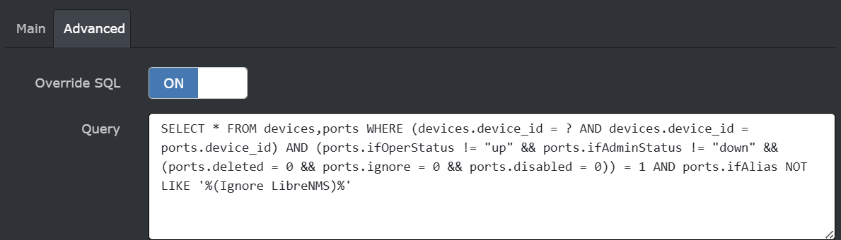

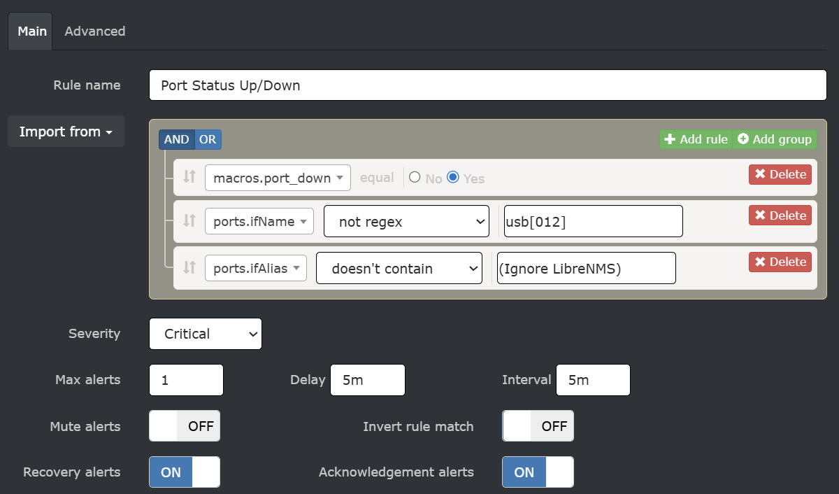

  2. Share your alert rule
I will upgrade to the latest version and test but in the meantime, this is the rule.
You should probably uncheck override SQL.
