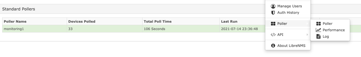

Thanks, where do I find the polling duration?
In the Poller menu :
