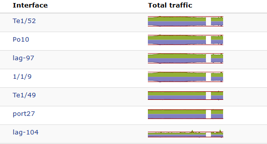

The graphs have a gap (the time between when the ./daily was executed and the ./lnms migrate):
