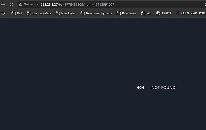

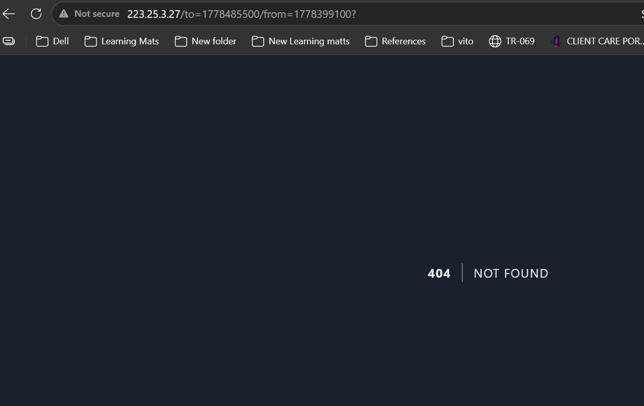

same here after update, when viewing graph using the custom date after clicking the update 404 error occurs
I think something is missing, look at the address bar after clicking on the update button.
hope this will be corrected soon.
Hello.
I’ve the same problem.
When I click a graph, select two dates and Update, the error
404 | Not found
is retrieved.

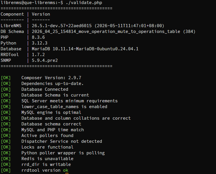

Validate.php:
LibreNMS 26.5.1-dev.58+83ba9e16b (2026-05-11T07:53:28+01:00)
DB Schema 2026_04_25_154814_move_operation_mute_to_operations_table (384)
PHP 8.4.20
Python 3.10.12
Database MariaDB 10.6.23-MariaDB-0ubuntu0.22.04.1
SNMP 5.9.1
[OK] Composer Version: 2.9.7
librenms@librenms:~$
Best regards.
