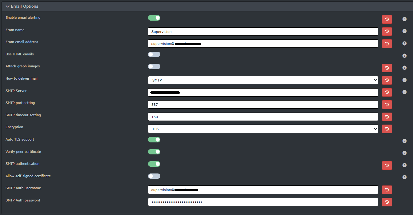

Hello, i have this issue for a while now (months), for any alert at any time, i will tell “random” since i cannot pinpoint the cause, i have an error and the mail for the alert isn’t sent. Curiously, the recovery mail is always sent. The error is flawed, since i can always reach the SMTP server

I understand, but i tried with two differents SMTP servers, and when i conduct a surveillance of connections to the servers, it’s always available, and the LNMS are the only ones to have a pseudo problem of connection..
I would like to know how to investigate further, and understand why it says this, because it does not seem to be the real root causes of the problem

Each alert is separate so if you’re seeing concurrency issues connecting to smtp then it suggests your mail server is limiting connections. Check by invoking simultaneous smtp connections manually.
I checked this hypothesis and i can enable multiple connections, and i’m far from the limit. i tried to catch packets with wireshark, check what’s happening on the ports, but nothing really add up, it’s sad but i think i will try to export via syslog instead of email, i don’t have any more ideas on what to test..
