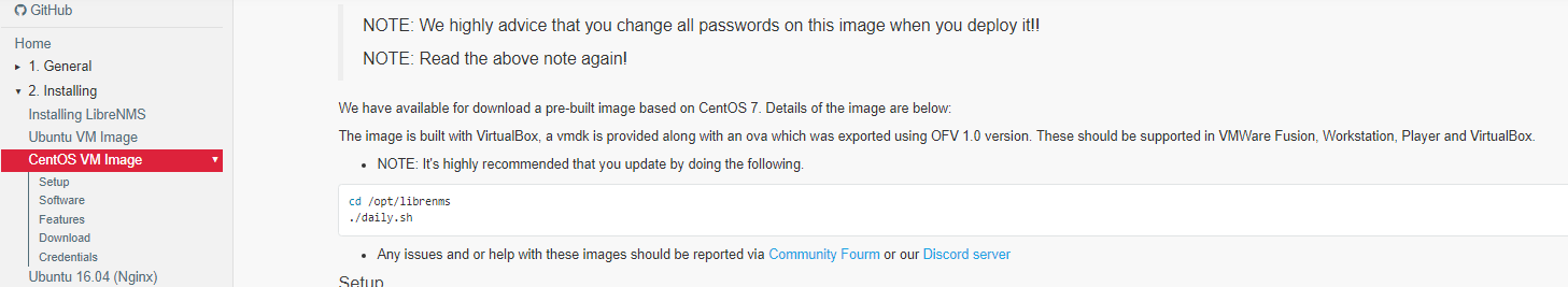

Covered in the docs look at docs.librenms.org
The first thing to do after you install VM image is to run updates.

To run updates.
cd /opt/librenms
./daily.sh
To get to the Web UI that totally depends what you have setup on the network.
Using your browser to get the WEB UI by IP address or hostname.
