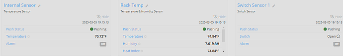

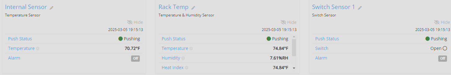

The detection now works, but only the temperature sensor appears to work.
And what sensors are you missing? Judging from Room Alert 3S Monitor - AVTECH.com this is basically just a networked temperature sensor?
Numerous sensors can be added to these via the digital sensor port. Our use case happens to have humidity monitoring probes attached. Here is the output from the device dashboard showing these sensors.
Alright. I can take a look, but you haven’t included a full snmpwalk output. Your upload contains only 20 lines.
If I may help…On Librenms 25.4, the 3S is detected but is only showing Farenheit value divided by 100. This device also has Celcius value used out of USA.
.1.3.6.1.2.1.1.1.0 = STRING: AVTECH RoomAlert 3S
.1.3.6.1.2.1.1.2.0 = OID: .1.3.6.1.4.1.20916
.1.3.6.1.2.1.1.3.0 = Timeticks: (292706) 0:48:47.06
.1.3.6.1.2.1.1.4.0 = STRING: [email protected]
.1.3.6.1.2.1.1.5.0 = STRING: RA3S-708EAB
.1.3.6.1.2.1.1.6.0 = STRING: EDITED
.1.3.6.1.2.1.1.7.0 = INTEGER: 7
.1.3.6.1.4.1.20916.1.13.1.1.1.1.0 = INTEGER: 49
.1.3.6.1.4.1.20916.1.13.1.1.1.2.0 = INTEGER: 10
.1.3.6.1.4.1.20916.1.13.1.3.1.0 = INTEGER: 0
.1.3.6.1.4.1.20916.1.13.1.4.1.1.0 = STRING: “Internal temperature”
.1.3.6.1.4.1.20916.1.13.1.4.3.1.0 = STRING: “Switch Sensor 1”
.1.3.6.1.4.1.20916.1.13.1.4.3.1.0.0 = No more variables left in this MIB View (It is past the end of the MIB tree)
So 49 is Fahrenheit and 10 is the Celcius value.

anyone ever update this ? i have my 3s going but its only showing the internal temp in C on the dashboard. If you look at it in health it shows the correct F temp. I also have an external sensor that does temp and humidity but that does not show up at all. is there also no way to change the name of the description too ?
