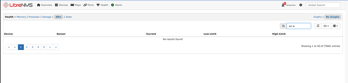

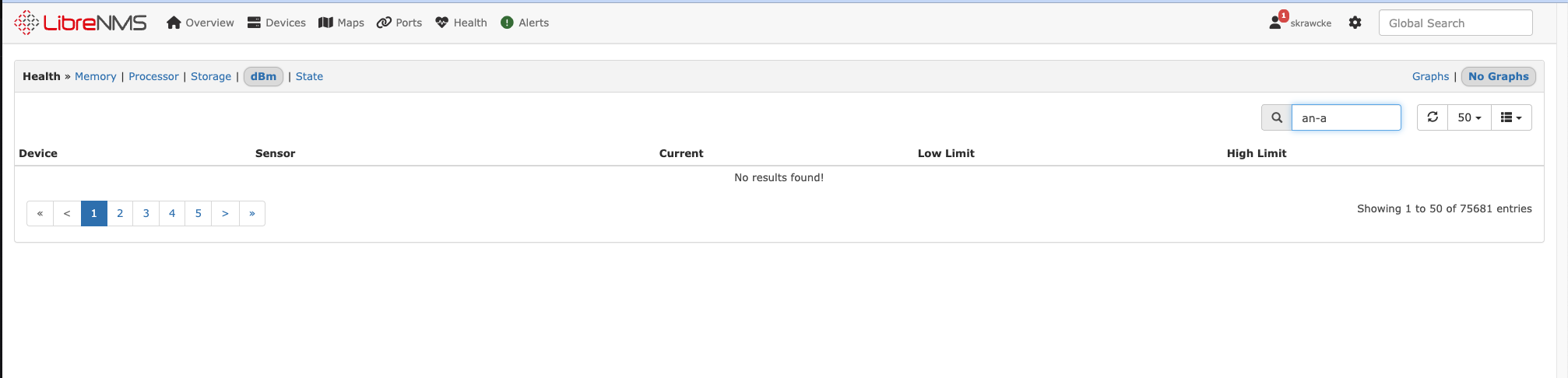

When using Health I can select any of the health statuses and try to search and it comes up blank
I worked yesterday and this morning it was no longer working.
I ran ./daily again and looks like another update came though
but I am still unable to search. Any guidance would be much appreciated.

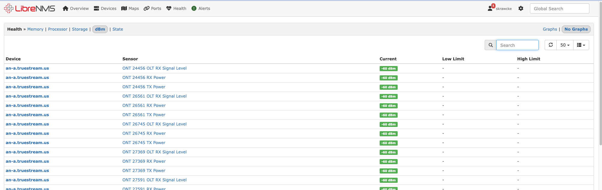

screen shots of what I am seeing
