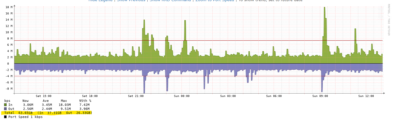

Does anyone have any SonicWALL devices added (2700 / 4700 / 6700), if so are your graphs / port speeds correct?
We have multiple SonicWALL devices which report the incorrect port speed, either 10kbps (for 10Gb ports) / 1kbps (For 1Gb ports)
The graphs for each port are also incorrect, bandwidth is much higher, but the graphs don’t match what is being transferred. The total bandwidth does look to be correct, but the graphs just don’t match the current usage. Could this be because of the incorrect port speed it’s reporting?
Does anyone have any ideas on what might be causing it, and any suggestions to resolve it?
