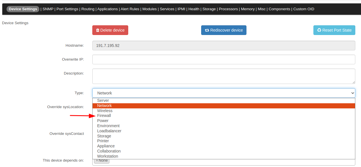

You can edit the type in device settings “Edit > Device Settings” and set as Firewall.
LibreNMS should automatically recognize it, I believe @murrant an fix that.
Thanks for the fast reply.
I will make a try and I let you know

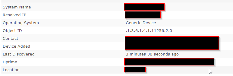

Did not seem to work.
This is what I got after I assigned firewall
fter looking in the config files, I have found that the sysObjectId in the config file ns-bsd.yaml is .1.3.6.1.4.1.8072.3.2.8 whereas the SN2100 the is the same !!!
I think I have to make my own device for this model …
