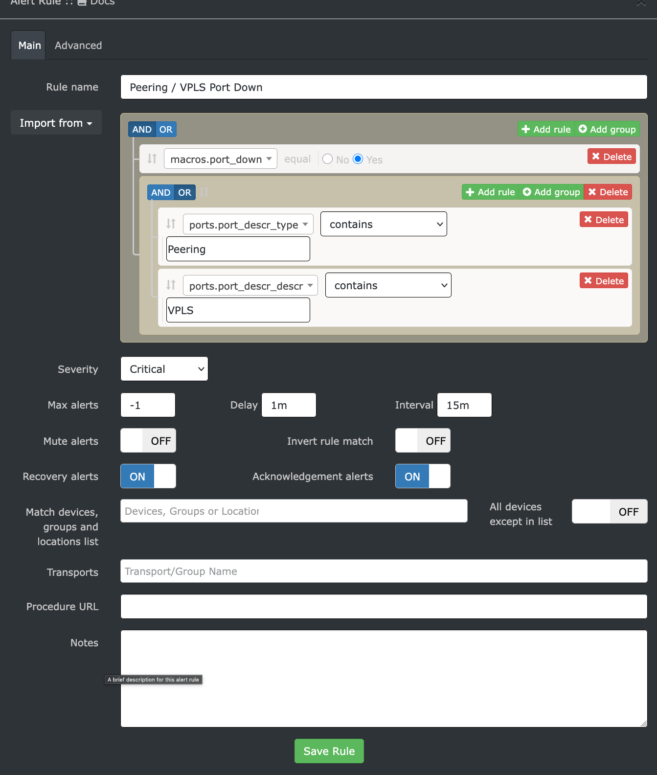

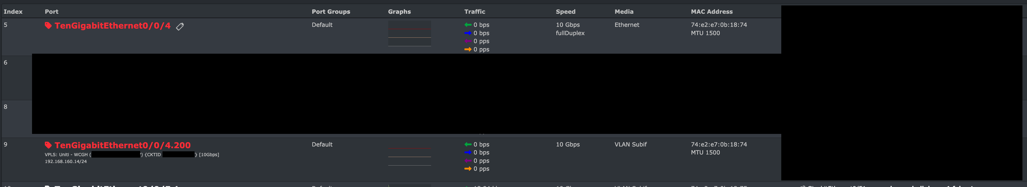

When using Interface Description Parsing with a SubInterface, the SubInterface will show on the applicable port page. However if an alert is then created to show when this subinterface is down, an alert is never generated. If the description is instead added to the physical interface, the alerts work fine.
The interface description and alert are built in Libre as follows:
