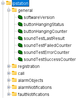

What is this ipstation device?
It’s probably the same station I was asked to snmpwalk again -
We have many of the “almost” same devices scattered around.
yup it was.
could you see if there are additional configurations you can apply regarding its SNMP?
or maybe a new firmware? or maybe a newer model of the same thing?
the walks don’t include any OIDS from the MIB and there’s a whole section related to the “ipstation”
on the website “The status of the stations is reported to AlphaWeb as well as to 3rd party management systems using SNMP, Syslog or OPC.”
maybe it has to be registered to a call server before it reports the information?
Alphacom = the call server (pbx server perhaps?)
And the rest of the devices are “phones” connected to the server in all different configurations both software and hardware so it’s kinda tricky.

otherwise, for the ipstations. its going to be pretty bare.
