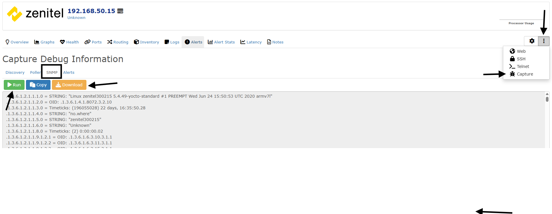

So I have collected some data on some Zenitel devices. Starting with “Device 1”
Discovery
LNMS
Snmpbulkwalk
I got the MIB-files from Zenitel - Not sure if I can publish them yet, but I have them so I can try them. And I will find out if I can publish them later on.

What do I need to do next?
Toyed around with ./scripts/new-os.php and failed every time!
But I have uploaded two MIBs I got from the manufacturer:
MIB-V3.txt
and
VS-Device-MIB
Hopefully someone can help me out

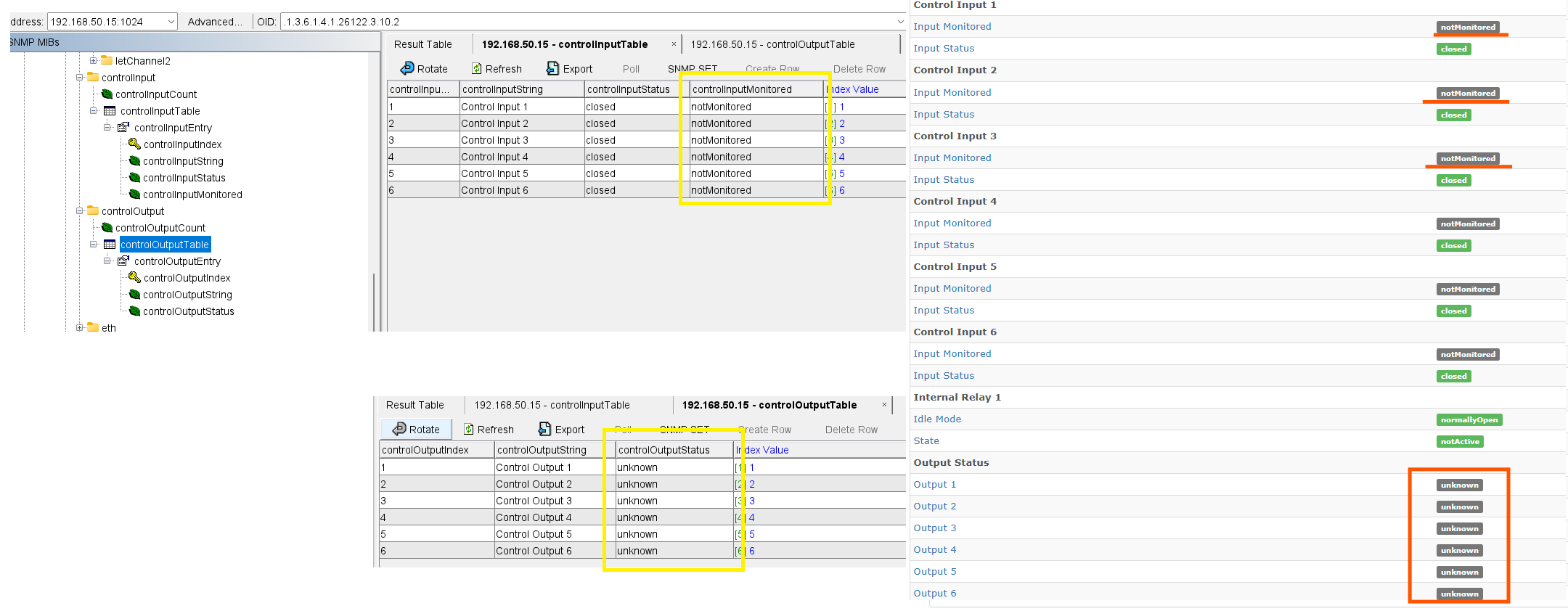

VS-DEVICE-MIB::lineInIndex.1 = INTEGER: 1
VS-DEVICE-MIB::lineInIndex.2 = INTEGER: 2
VS-DEVICE-MIB::lineInMonitoringState.1 = INTEGER: notMonitored(2)
VS-DEVICE-MIB::lineInMonitoringState.2 = INTEGER: notMonitored(2)
VS-DEVICE-MIB::lineInType.1 = INTEGER: microphoneExtern(4)
VS-DEVICE-MIB::lineInType.2 = INTEGER: microphoneIntern(5)
VS-DEVICE-MIB::lineInString.1 = STRING: Microphone Extern
VS-DEVICE-MIB::lineInString.2 = STRING: Microphone Intern
VS-DEVICE-MIB::lineInStatus.1 = INTEGER: microphoneDisconnected(6)
VS-DEVICE-MIB::lineInStatus.2 = INTEGER: microphoneConnected(5)
VS-DEVICE-MIB::ampChannelCount.0 = INTEGER: 1
VS-DEVICE-MIB::ampType.0 = INTEGER: turbine(2)
VS-DEVICE-MIB::ampChannelIndex.1 = INTEGER: 1
VS-DEVICE-MIB::ampChannelString.1 = STRING: Turbine output
VS-DEVICE-MIB::ampChannelStatus.1 = INTEGER: unknown(1)
VS-DEVICE-MIB::ampChannelMonitorStatus.1 = INTEGER: unknown(1)
VS-DEVICE-MIB::letChannel1Count.0 = INTEGER: 0
VS-DEVICE-MIB::letChannel2Count.0 = INTEGER: 0
VS-DEVICE-MIB::controlInputCount.0 = INTEGER: 6
VS-DEVICE-MIB::controlInputIndex.1 = INTEGER: 1
VS-DEVICE-MIB::controlInputIndex.2 = INTEGER: 2
VS-DEVICE-MIB::controlInputIndex.3 = INTEGER: 3
VS-DEVICE-MIB::controlInputIndex.4 = INTEGER: 4
VS-DEVICE-MIB::controlInputIndex.5 = INTEGER: 5
VS-DEVICE-MIB::controlInputIndex.6 = INTEGER: 6
VS-DEVICE-MIB::controlInputString.1 = STRING: Control Input 1
VS-DEVICE-MIB::controlInputString.2 = STRING: Control Input 2
VS-DEVICE-MIB::controlInputString.3 = STRING: Control Input 3
VS-DEVICE-MIB::controlInputString.4 = STRING: Control Input 4
VS-DEVICE-MIB::controlInputString.5 = STRING: Control Input 5
VS-DEVICE-MIB::controlInputString.6 = STRING: Control Input 6
VS-DEVICE-MIB::controlInputStatus.1 = INTEGER: closed(3)
VS-DEVICE-MIB::controlInputStatus.2 = INTEGER: closed(3)
VS-DEVICE-MIB::controlInputStatus.3 = INTEGER: closed(3)
VS-DEVICE-MIB::controlInputStatus.4 = INTEGER: closed(3)
VS-DEVICE-MIB::controlInputStatus.5 = INTEGER: closed(3)
VS-DEVICE-MIB::controlInputStatus.6 = INTEGER: closed(3)
VS-DEVICE-MIB::controlInputMonitored.1 = INTEGER: notMonitored(1)
VS-DEVICE-MIB::controlInputMonitored.2 = INTEGER: notMonitored(1)
VS-DEVICE-MIB::controlInputMonitored.3 = INTEGER: notMonitored(1)
VS-DEVICE-MIB::controlInputMonitored.4 = INTEGER: notMonitored(1)
VS-DEVICE-MIB::controlInputMonitored.5 = INTEGER: notMonitored(1)
VS-DEVICE-MIB::controlInputMonitored.6 = INTEGER: notMonitored(1)
VS-DEVICE-MIB::controlOutputCount.0 = INTEGER: 0
VS-DEVICE-MIB::controlOutputIndex.1 = INTEGER: 1
VS-DEVICE-MIB::controlOutputIndex.2 = INTEGER: 2
VS-DEVICE-MIB::controlOutputIndex.3 = INTEGER: 3
VS-DEVICE-MIB::controlOutputIndex.4 = INTEGER: 4
VS-DEVICE-MIB::controlOutputIndex.5 = INTEGER: 5
VS-DEVICE-MIB::controlOutputIndex.6 = INTEGER: 6
VS-DEVICE-MIB::controlOutputString.1 = STRING: Control Output 1
VS-DEVICE-MIB::controlOutputString.2 = STRING: Control Output 2
VS-DEVICE-MIB::controlOutputString.3 = STRING: Control Output 3
VS-DEVICE-MIB::controlOutputString.4 = STRING: Control Output 4
VS-DEVICE-MIB::controlOutputString.5 = STRING: Control Output 5
VS-DEVICE-MIB::controlOutputString.6 = STRING: Control Output 6
VS-DEVICE-MIB::controlOutputStatus.1 = INTEGER: unknown(1)
VS-DEVICE-MIB::controlOutputStatus.2 = INTEGER: unknown(1)
VS-DEVICE-MIB::controlOutputStatus.3 = INTEGER: unknown(1)
VS-DEVICE-MIB::controlOutputStatus.4 = INTEGER: unknown(1)
VS-DEVICE-MIB::controlOutputStatus.5 = INTEGER: unknown(1)
VS-DEVICE-MIB::controlOutputStatus.6 = INTEGER: unknown(1)
VS-DEVICE-MIB::ethMonitoringIndex.1 = INTEGER: 1
VS-DEVICE-MIB::ethMonitoringIndex.2 = INTEGER: 2
VS-DEVICE-MIB::ethMonitoringString.1 = STRING: Eth 1
VS-DEVICE-MIB::ethMonitoringString.2 = STRING: Eth 2
VS-DEVICE-MIB::ethMonitoringState.1 = INTEGER: notMonitored(2)
VS-DEVICE-MIB::ethMonitoringState.2 = INTEGER: notMonitored(2)
VS-DEVICE-MIB::relayIndex.1 = INTEGER: 1
VS-DEVICE-MIB::relayIndex.2 = INTEGER: 2
VS-DEVICE-MIB::relayIndex.3 = INTEGER: 3
VS-DEVICE-MIB::relayIndex.4 = INTEGER: 4
VS-DEVICE-MIB::relayString.1 = STRING: Internal Relay 1
VS-DEVICE-MIB::relayString.2 = STRING: Internal Relay 2
VS-DEVICE-MIB::relayString.3 = STRING: Extension Relay 1
VS-DEVICE-MIB::relayString.4 = STRING: Extension Relay 2
VS-DEVICE-MIB::relayIdleMode.1 = INTEGER: normallyOpen(3)
VS-DEVICE-MIB::relayIdleMode.2 = INTEGER: normallyOpen(3)
VS-DEVICE-MIB::relayIdleMode.3 = INTEGER: normallyOpen(3)
VS-DEVICE-MIB::relayIdleMode.4 = INTEGER: normallyOpen(3)
VS-DEVICE-MIB::relayDelay.1 = INTEGER: 0
VS-DEVICE-MIB::relayDelay.2 = INTEGER: 0
VS-DEVICE-MIB::relayDelay.3 = INTEGER: 0
VS-DEVICE-MIB::relayDelay.4 = INTEGER: 0
VS-DEVICE-MIB::relayState.1 = INTEGER: notActive(2)
VS-DEVICE-MIB::relayState.2 = INTEGER: notActive(2)
VS-DEVICE-MIB::relayState.3 = INTEGER: notActive(2)
VS-DEVICE-MIB::relayState.4 = INTEGER: notActive(2)

snmpwalk of Stentofon Turbine Compact
snmpwalk -v2c -c random -m VS-DEVICE-MIB 192.168.54.203 .1.3.6.1.4.1.26122
VS-DEVICE-MIB::infoPackageVersion.0 = STRING: 9.0.3.3 (vsft)
VS-DEVICE-MIB::infoModelType.0 = STRING: Stentofon Turbine Compact
VS-DEVICE-MIB::infoModelNumber.0 = INTEGER: 8121
VS-DEVICE-MIB::infoAmplifierType.0 = STRING:
VS-DEVICE-MIB::infoKernelVersion.0 = STRING: 3.10.0[st_dev]+ #1 PREEMPT Fri Dec 6 13:47:58 UTC 2024
VS-DEVICE-MIB::infoDeviceTreeVersion.0 = STRING: 02
VS-DEVICE-MIB::infoDisablement.0 = INTEGER: online(2)
VS-DEVICE-MIB::tempTableCount.0 = INTEGER: 0
VS-DEVICE-MIB::fanTableCount.0 = INTEGER: 0
VS-DEVICE-MIB::voltageTableCount.0 = INTEGER: 0

Snmprec of the Zenitel AlphacomXE server
Pastebin AlphaComXE
Have several recordings of various Zenitel devices as well, that would need some attention.
I got the 3 devices working.
See PR : Add support for Zenitel Devices by sandap1 · Pull Request #18711 · librenms/librenms · GitHub
could you attach a full walk for the Zenitel IP Desk device?
and whatever else you have for them.
I’m on a holiday break right now but I will come back to you as soon as I can! Thanks a lot for the work you have done here! Thanks @deagle746
Stentofon IPDM-V2 (?)
Here you go @deagle746

Not quite , could you please use the “capture” - SNMP tab to collect it.
ah I see!
I have to use pastebin then @deagle746

@deagle746

could you try walking it again?

Should the inputs that are “notmonitored” be ignored?
should the outputs with an “unknown” status be ignored?
