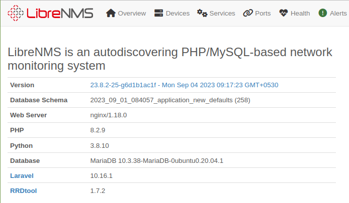

In have configured Librenms to log syslog from remote servers.
The versions used are as shown in the image below.
The syslog for the remote device is empty
