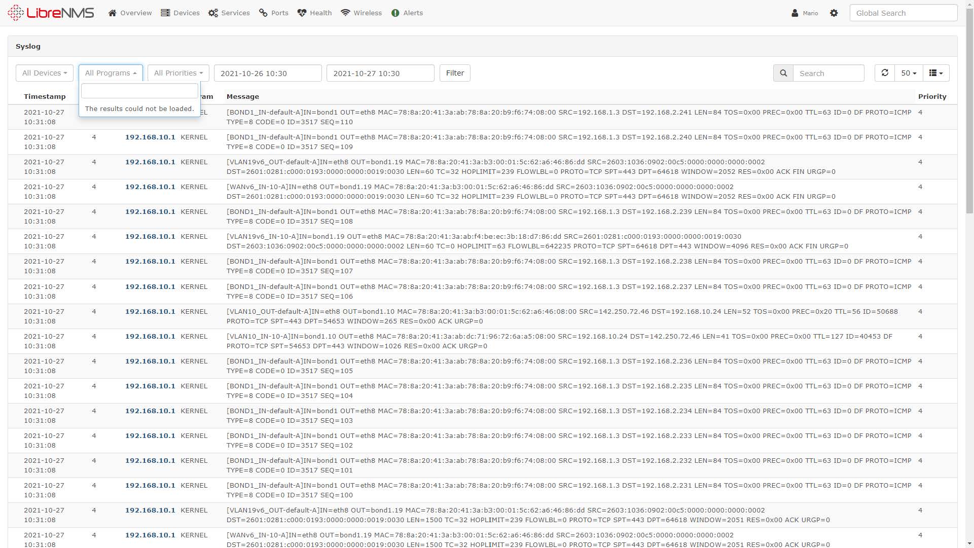

I am running into a Syslog problem and have not figured out the cause of it…
I am sending all my network devices syslogs to the LibreNMS server that is running on a Ubuntu 20.04 VM. Presently, I have around 100 million syslog records in the database.
All is working properly except that the All Programs tab does not populate any program names for me to select from. After the install of LibreNMS, this tab was being populated correctly, but something has changed and now that tab is not populating at all with any information. I have made no changes to LibreNMS since the install.

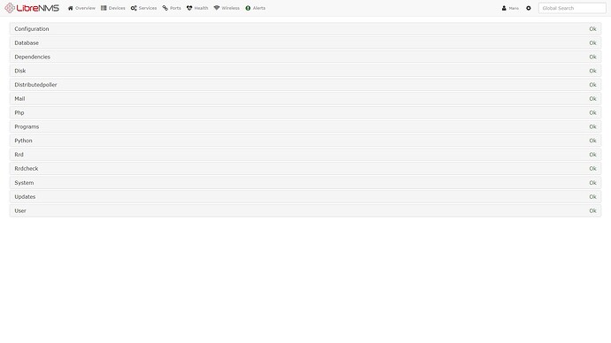

I’m attaching a copy of the syslog page screen shot, along with the results of the validate.
Looking at /opt/librenms/logs, I see nothing unusual…

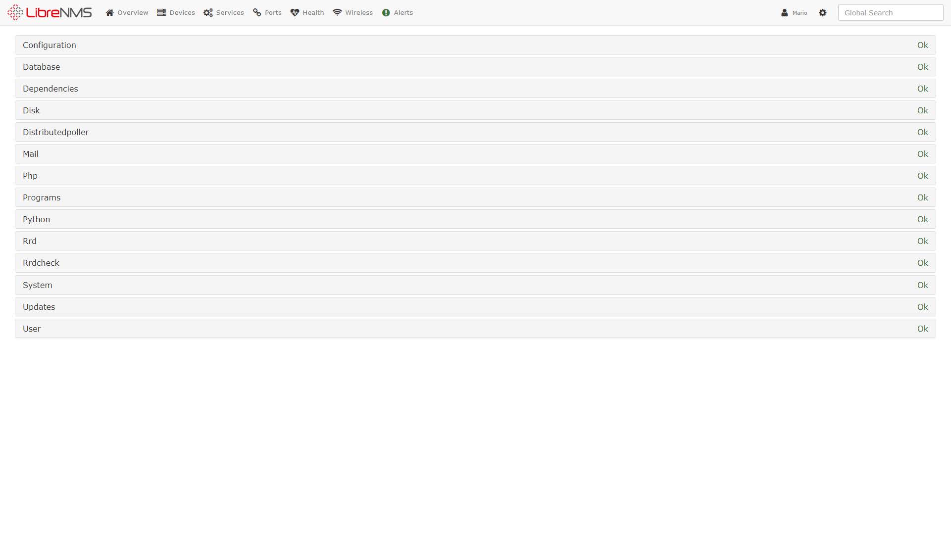

Here is the validate screen shot
This problem appears to be related to the large size of the syslog table.
I decided to “truncate” the syslog table, and now the All Programs tab works fine, as well as the All Priorities tab.
At some point, as the size of the syslog table grows rather large, those two tabs stop working. Is there a particular setting that can be changed that might impact this functionality?
