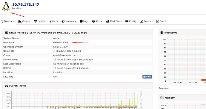

However it doesn’t appear correctly into LibreNMS, it sees it as just a Linux server.
What we see:
If I run a mib walk based on your discovery.yml which might be the issue:
snmpwalk -v2c -c iVision 10.10.10.123 1.3.6.1.4.1.8072.3.2.10
iso.3.6.1.4.1.8072.3.2.10 = No Such Object available on this agent at this OID

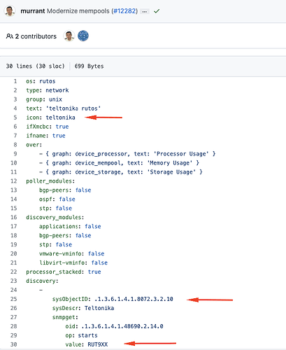

It means it doesn’t match the criteria in https://github.com/librenms/librenms/blob/master/includes/definitions/rutos.yaml
Patches welcome
So what needs to be done here please?
Your sysDescr does not contain “Teltonika” so perhaps remove that from the definition.
sysObjectID is not an oid you can can snmpget it is just an identifier. 1.3.6.1.4.1.8072.3.2.10 happens to be the generic Linux sysObjectID.
So I just remove the ‘sysObjectID’ from your rutos.yml file?
NO, remove sysDescr line. If that works, send a pull request.
Done and then run a rediscover on 1 of the routers?
Yes, but you need to enable debug -d to clear the OS cache.
They are now show as Teltonika routers. What file do I now edit to add the new OID to show up which uses OID = 1.3.6.1.4.1.48690.5.3?
