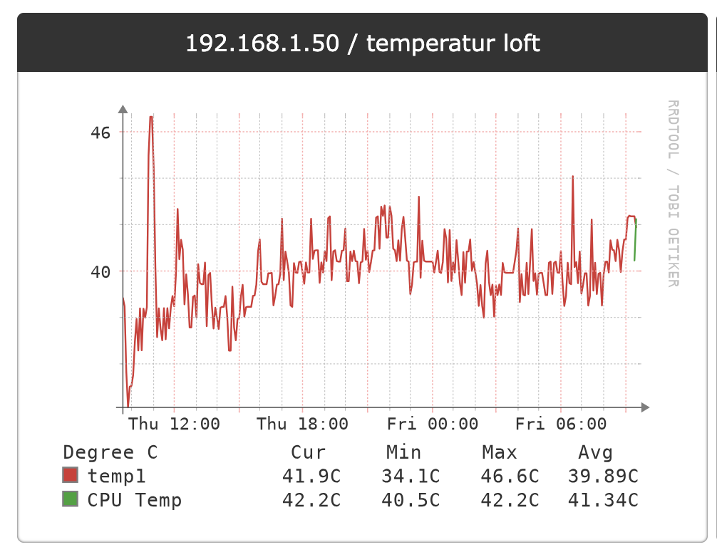

So I have 3 three rpi’s around the house. Everyone is added to Librenms to show temperatures via a external temp sensor. Allthough I’ve hadde issues when the temps goes below 0C, something new happend today(?)
The sensor on my Librenms rpi all the sudden switched to Fahrenheit! But it shows as Celius, but some there is no way there is 48 degress C where the rpi is running. It’s on running in a ventilated loft. So when I run python code to display the temp on the external sensor it shows me:

And Librenms displays this:

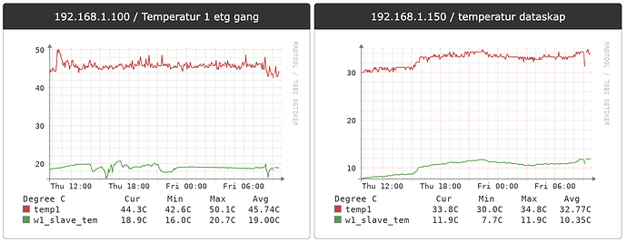

And my other 2 rpi’s displays like normal (the sensors is indoors)
