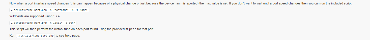

Try run rrdtune script on it
https://docs.librenms.org/#Extensions/RRDTune/
and turn on RRDTune on the device, Edit Device -> Misc

https://docs.librenms.org/Support/FAQ/#why-do-i-see-traffic-spikes-in-my-graphs
Hello again, so with RRDTune enabled, I have seen one spike (100Gbps on a 1Gbps link) since. This is a lot less than previously but I’l look into it a bit more today and see if I can find the cause.
you have to run the scripts also.
Thanks Kevin sorry I missed that step, assumed that enabling them would automatically run them.
Have done now and will see how it goes.
Appreciate the help :slight_smile:
Hello again, so I enabled the setting globally, as well as on the port affected (only one port, our main uplink) and have run the scripts but I am still seeing the same. Which logs would be helpful to see what is causing it?
You can try running the poller with debug and see if it is failing to return data sometimes or what. ./poller.php -h HOSTNAME -r -f -d -m ports
