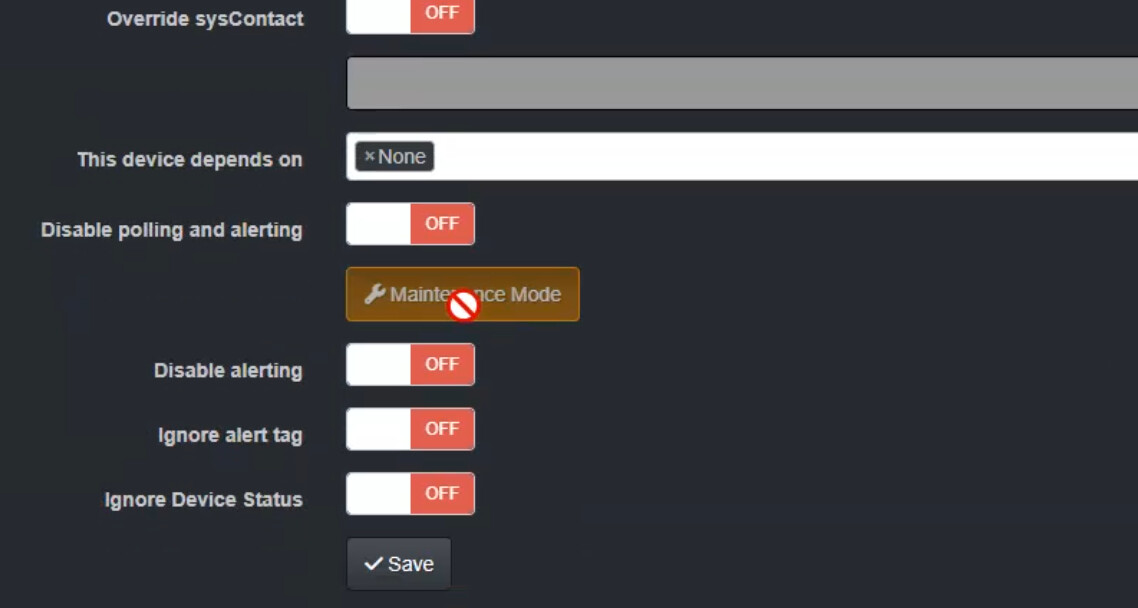

I am unable to use the webUI to remove a device from maintenance mode and I don’t know why:

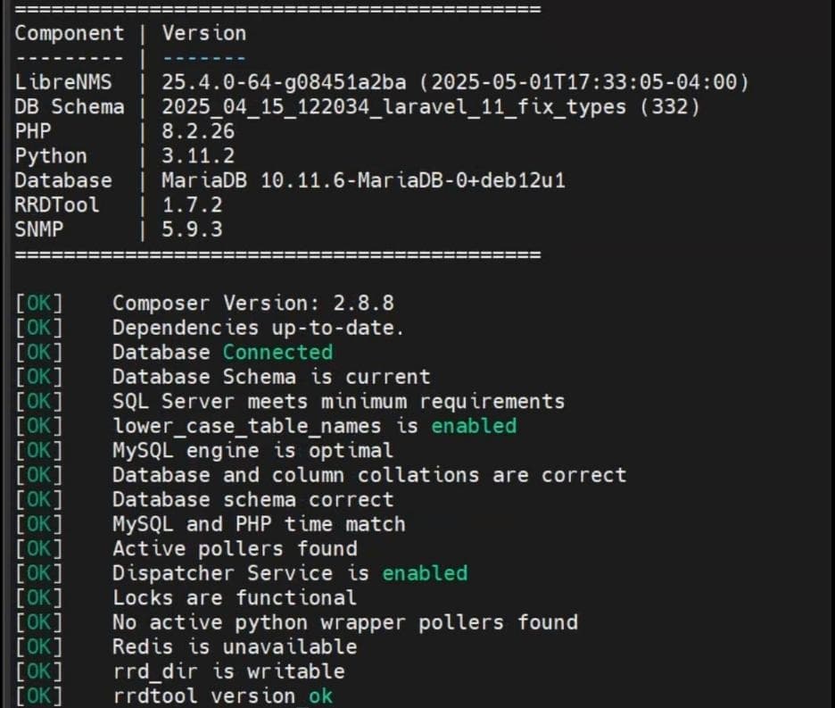

Here is the system info:

Go to Alerts > Scheduled Maintenance and then click the trash icon for the device you want to take out of maintenance mode or change the end time for it
It sure would make sense if that button did something :smiley:
Thanks!! I’ll give that a try and let you know.
That worked!! I guess this process has changed recently and I missed that. Thanks again!!
