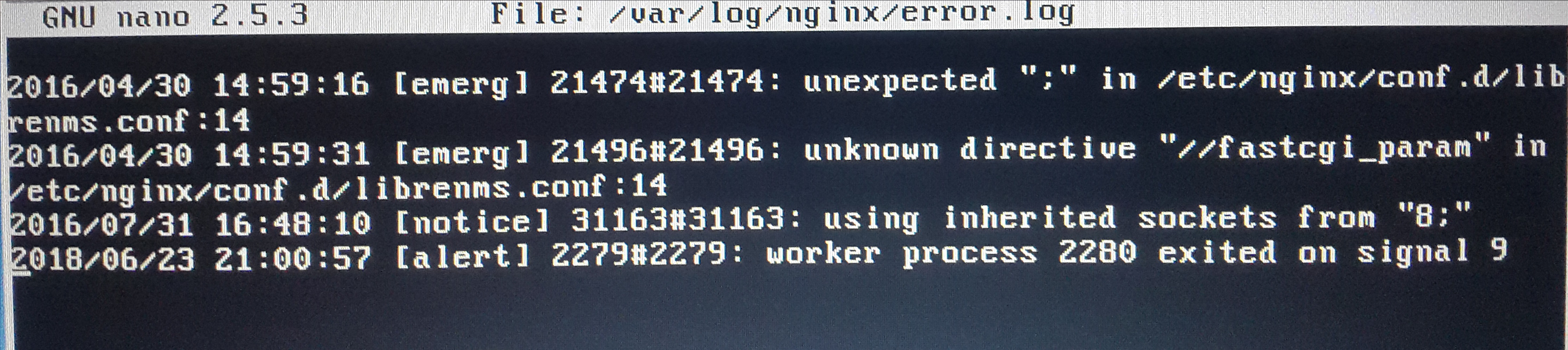

Not sure if if the following error has to do with the issue:

It’s not related, but you still need it to be fixed. Have you tried running discover manually?

So there are 2 clear errors here - an unexpected ; and an unknown directive (ie most likely wrong placement of or the // in fastcgi_param).
If you want to comment sth out use #. If you want to give a path, a single / is needed.
I think they aren´t relevant as there is no even ¨fastcgi_param¨ in the script.

Here is a portion of the output of sudo nano /etc/nginx/conf.d/librenms.conf : lines 11 - 15
 location ~ \.php {
  include fastcgi.conf;
  fastcgi_split_path_info ^(.+\.php)(/.+)$;
  fastcgi_pass unix:/var/run/php/php7.0-fpm.sock;
Can you post the rest of the file?
Maybe there is an issue with one of the includes?
