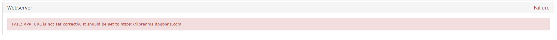

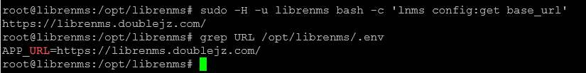

I can’t seem to figure out what’s going on here. I tried commenting out APP_URL in the .env so ‘APP_URL’ => $config[‘base_url’] but that didn’t work.
I currently have both the APP_URL and base_url the same and its still mad.
FAIL: APP_URL is not set correctly. It should be set to https://librenms.doublejz.com
Not sure what changed as I didn’t change anything, even stood up a new server and migrated over to it to be safe… same thing.

Try removing the final /
Not sure if that fixed it or not. I did remove it but I also upgraded from Ubuntu 22.04.5 to 24.04.2 before validating again so I might have jiggled something loose.
Either way its validating cleanly now. TY
