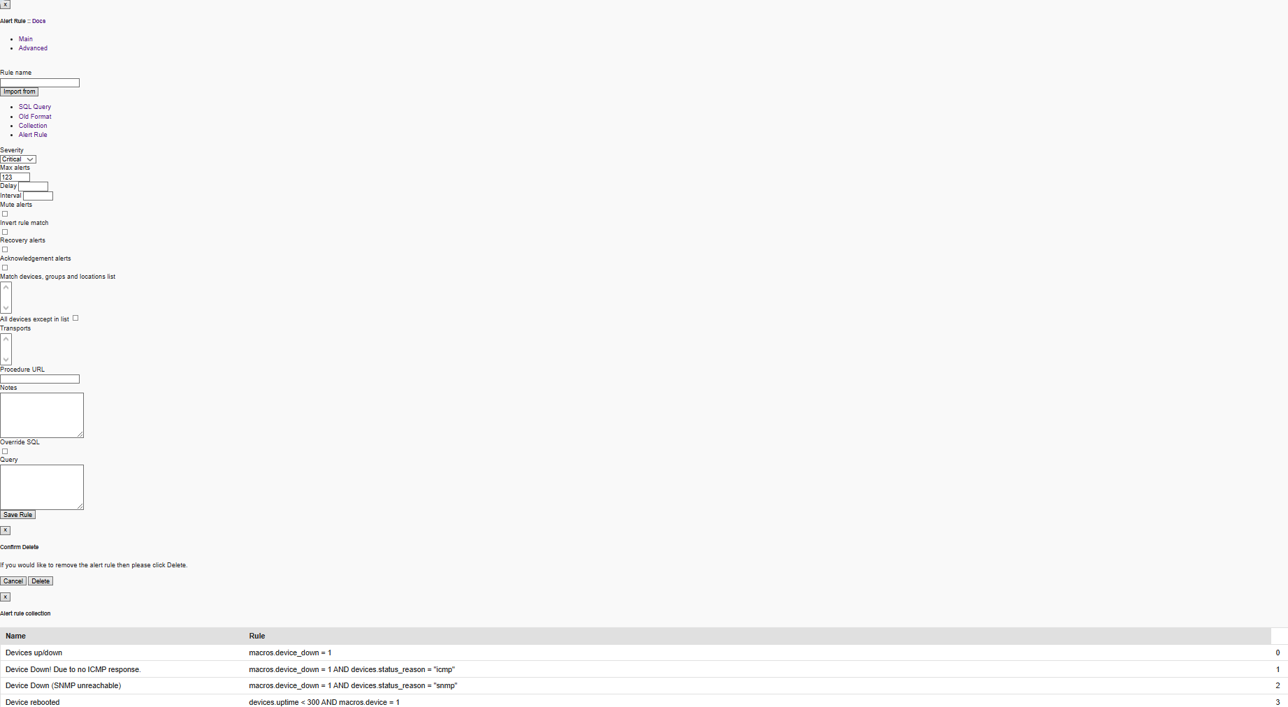

Hello everyone, I have a slightly different issue, but it also concerns alerts. Specifically, I’m having problems loading the /alert-rules and /alert-transports pages. This started happening after the last update. Can anyone help me? There’s nothing in the logs, and all other tabs are working.
Edit
The problem was resolved. I found in the log:
[CRITICAL] Exception: Error Class “LibreNMS\Alert\Transport\Weechatbot” not found @ /opt/librenms/LibreNMS/Alert/Transport.php:35
It turned out that the filename and the declared class WeechatBot were incorrect. Something must have changed after the update, because it was class WeechatBot.php — it should be Weechatbot.php and class Weechatbot
