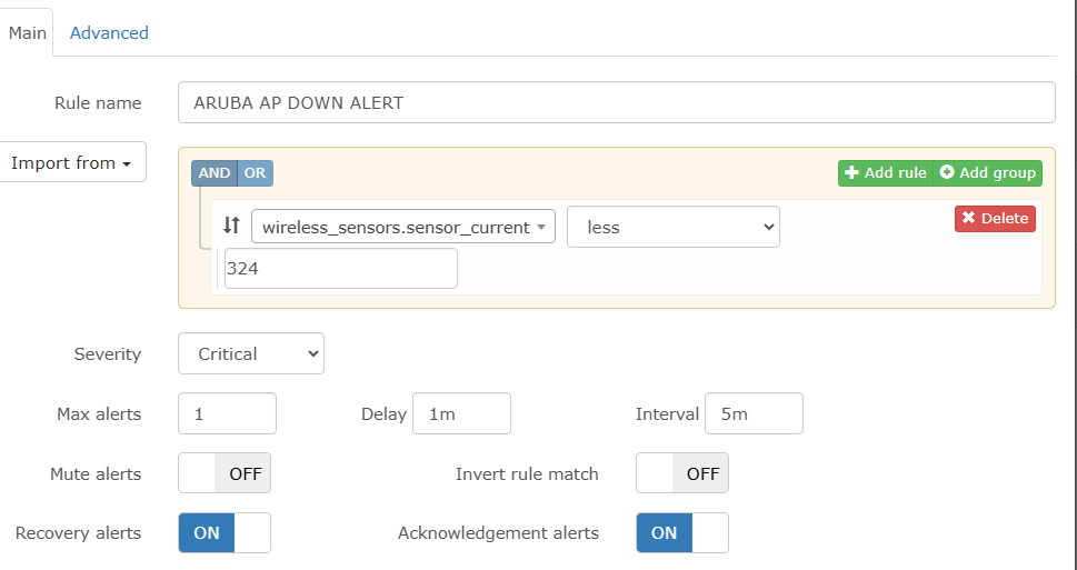

I have an issue with LibreNMS. I added my Aruba WLC to LibreNMS and created an AP-down alert using the following logic rule:
wireless_sensors.sensors_current < 324
It worked properly for a few days, but now it is triggering alerts even though no APs have gone down.
You most likely want to check for other items in the wireless_sensors table, like limit it based on sensor_descr or sensor_type.
Look in your wireless_sensors table to see what’s in there
