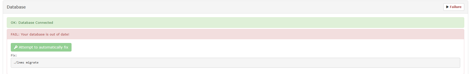

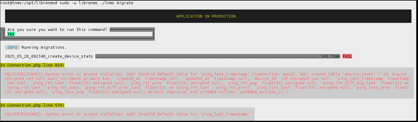

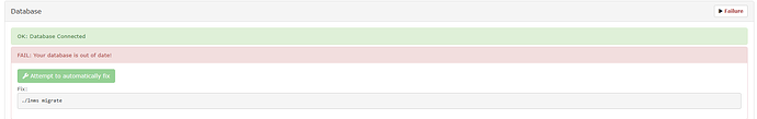

[FAIL] Your database is out of date!
./lnms migrate
Attempt to fix this issue (y or n)?:n
