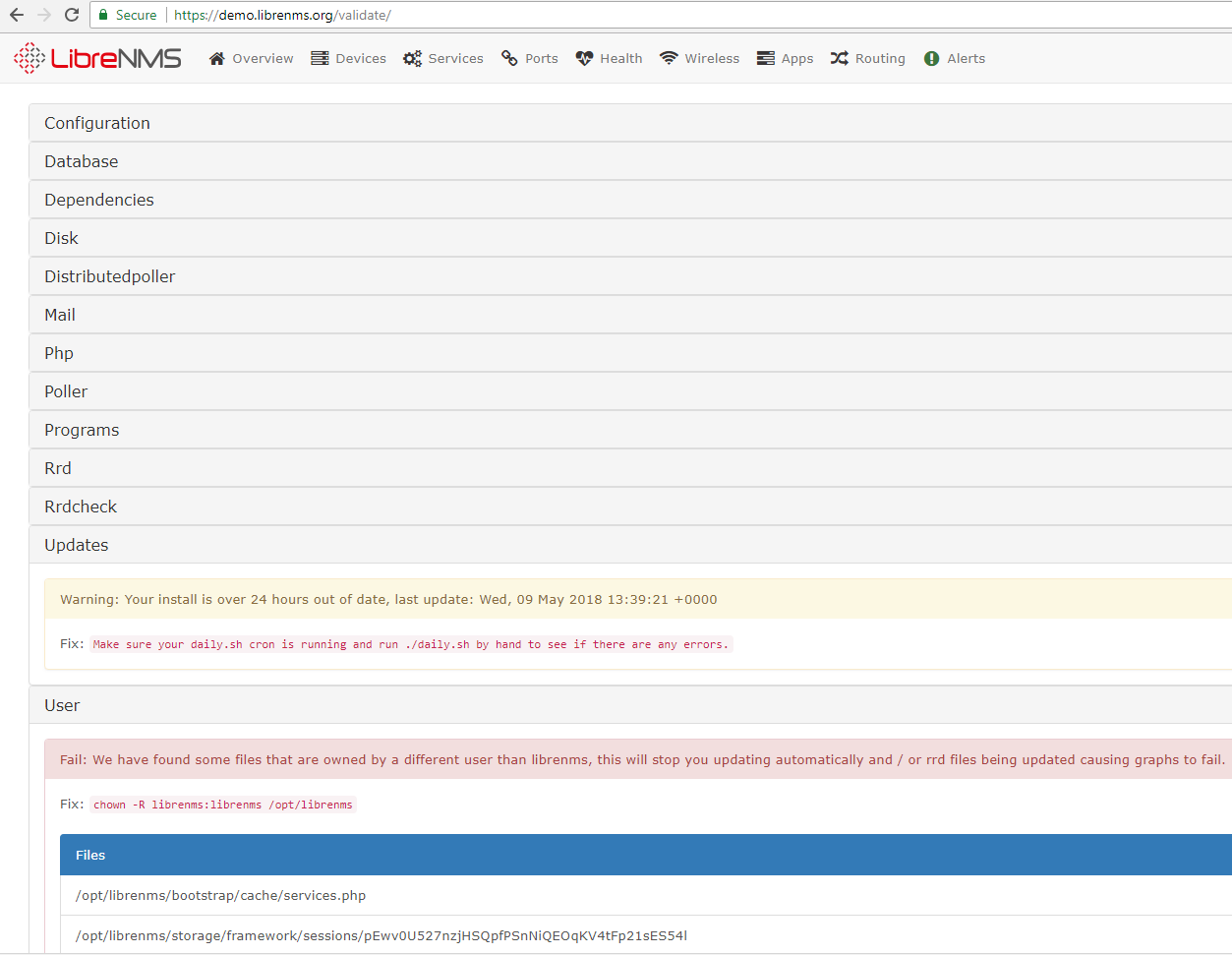

I am having the same issue, however each time a new web session is started from a different location this file keeps having the permission reset to www-data:www-data --> “/opt/librenms/bootstrap/cache/services.php” and the “/opt/librenms/storage/framework/sessions/” just fills up with session files with the same permissions www-data:www-data!
This is a setup right out of the book…no weird settings here

looks like the main Librenms Demo site is having this issue as well
