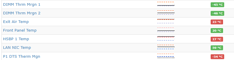

A 3.3v battery sensor “BB +3.3V Vbat” now has limits of high, 13.696, high warn, 13.311, low warn 11.001, low 10.616, so is triggering a low voltage alert. These limits are appropriate for a 12v voltage sensor which is an adjacent sensor in the sensor list.
“P1 DTS Therm Mgn”, which is normally a negative number around -53C (a lot of margin values are negative) suddenly has high and low limits of 115C and 0C so is also alerting.
A final example is “Exit Air Temp” of a server, current value is 24C which is perfectly normal, but the high and low limits are suddenly +10C for the high limit and -66C for the low limit!
I have dozens more. Basically it appears the sensor reported values are correct but all the high and low sensor limit values have played musical chairs among all the sensors and are no longer applied to the correct sensors which has effectively completely broken sensor limit reporting as nothing I’ve looked at has sane high and low limits anymore.

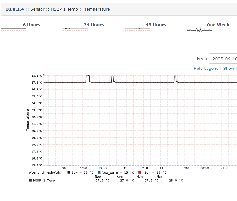

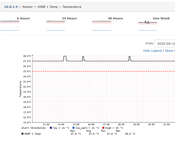

Edit: I’ve also noticed that some of the temperature sensors I have linked directly to graphs on a dashboard have changed and now point to the wrong sensor. For example, this graph linked from the dashboard via a direct URL in an image widget was previously “Front Panel Temp” on a server, but now the same sensor ID is a different sensor, “HSBP 1 Temp”:
Looking at the server, these are adjacent sensors in the list, so the sensor index seems to have been offset by one:
So now the URL which used to link to “Front Panel Temp” links to “HSBP 1 Temp”.
