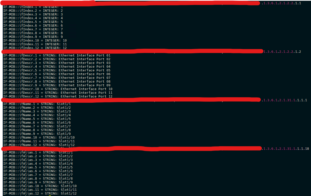

The biggest thing, and this might be a limitation of snmp on the device itself, is that it isn’t pulling in the port descriptions as they are set on the switch. It puts in the generic “Ethernet Interface Port 01” etc.

What it’s pulling in is from the standard if-mib. Can you show me what the port description looks like you would want. I’ll have to find which mib holds that data.

Here is what it pulls:
Right, the IF-MIB doesn’t have your port descriptions.

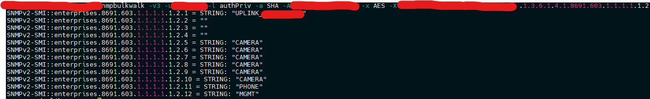

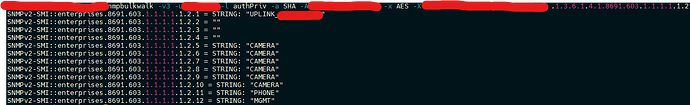

Doing a walk and specifying .1.3.6.1.4.1.8691.603.1.1.1.1.2 shows me the custom port descriptions that are set on the switch.

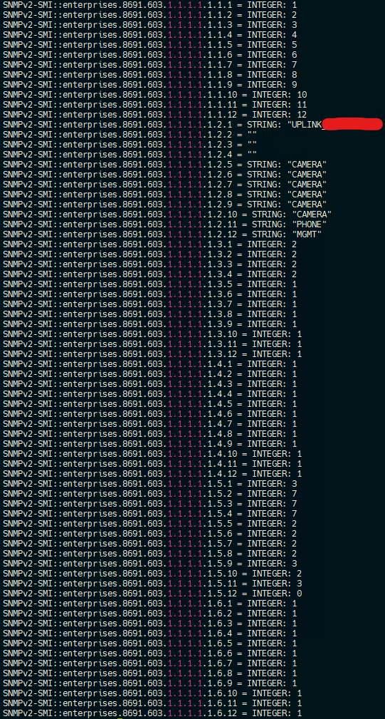

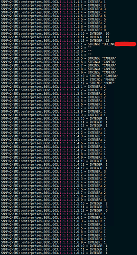

Here is the output of walking that OID:
1.3.6.1.4.1.8691.603.1.1.1.1 will indeed work, but if you want to be more granular 1.3.6.1.4.1.8691.603.1.1.1.1.2 will specifically pull the entries related to the port description/alias that I set.
Walk Output
