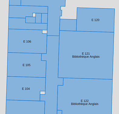

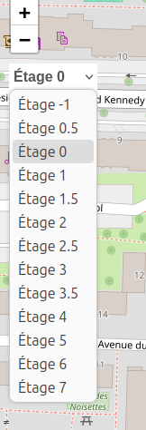

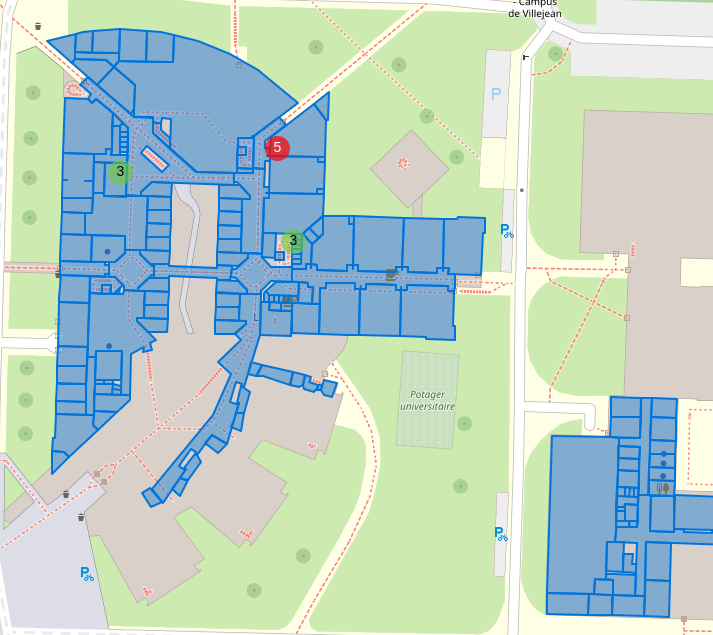

I’ve developed a piece of code to display the Librenms map with a floor selector like https://indoorequal.org.
We’re lucky to have GeoJSON data for our buildings / floors / Ref / name / imported into Leaflet.

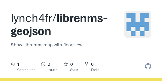

Here’s the result if you’re interested. This add-on is not in the form of a plugin, so you’ll have to modify the files manually each time you update (./daily.sh).
The steps :
1 - Check that your buildings have a floor view on: https://indoorequal.org
2 - Export your building geojson files to https://overpass-turbo.eu/
3 - Copy your geojson files to /librenms/html/tiles
4 - Modify the code /librenms/html/js/librenms.js
5 - Modify the code /librenms/html/css/styles.css
