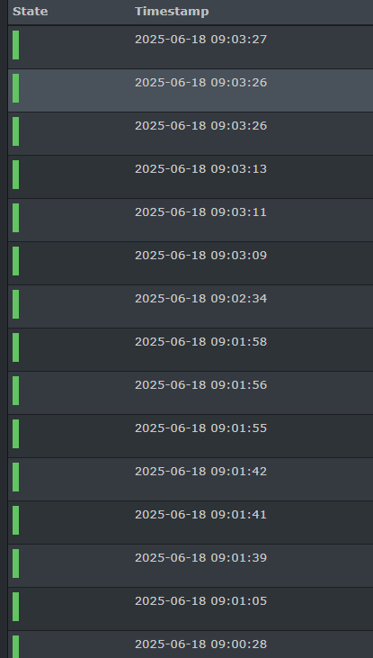

This morning I am seeing my UP alerts are going off for seemingly no reason, filling up the alert history with 5+ alerts every minute.

More like this for the whole morning, I have restarted all 3 of my pollers including the master librenms server with no success
